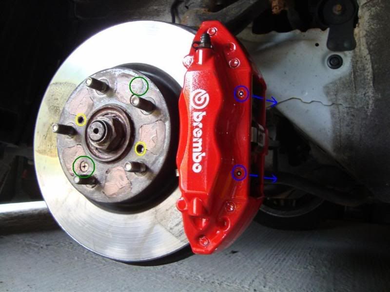

A - Knock out the pad retailing pins circled blue. The pad retaining clip should then fall out.

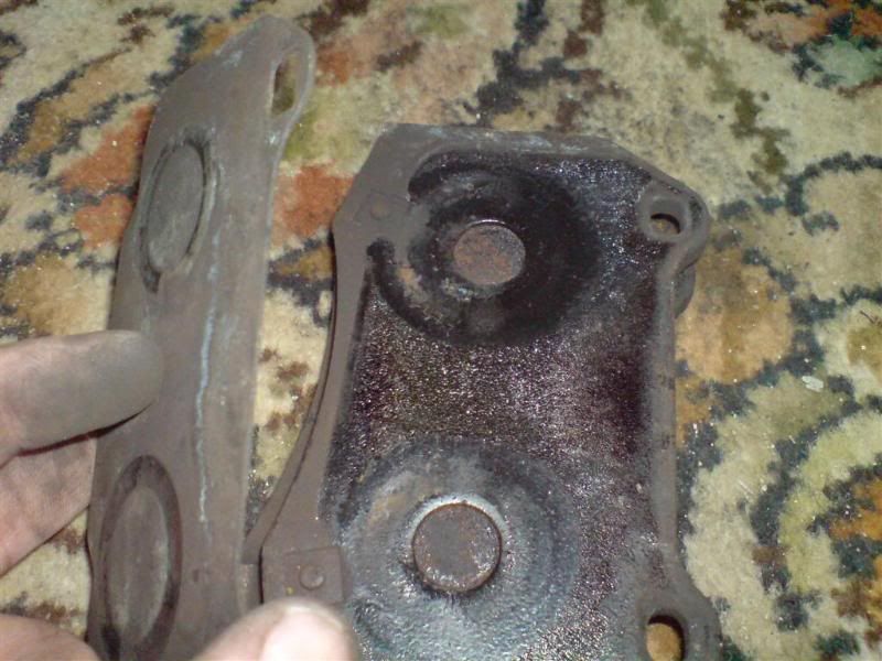

D - If your old pads are OEM, remove the shim off the back so you can use it on your new pads.
E - After placing the shim back on, apply a small amount of copper grease to the back of the shim.

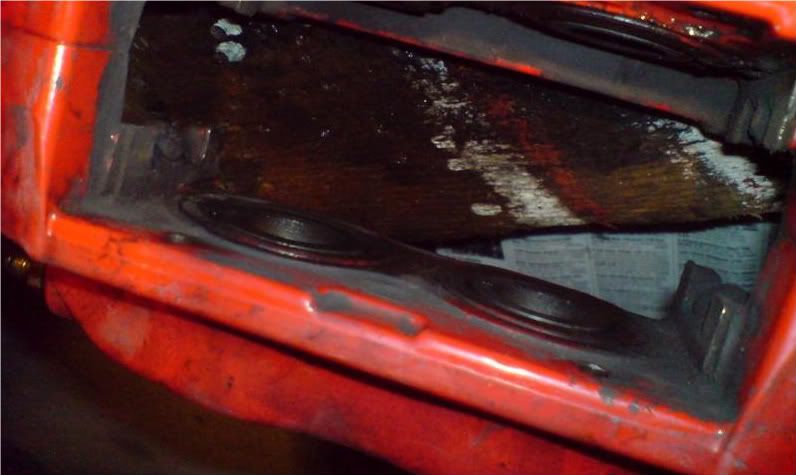

F - To be able to put the new pads back in you will need to push the pistons back in slightly. I was able to do this with my hands but if you cant then you can remove the caliper in order to use a C clamp (see STEP 2 -B,C and G)
G - After pushing the pistons back in, slide in the new pads.

D - Undo the two screws holding the disc onto the hub. These are marked in green on the first picture. They are very tight and so make sure you have the correct size screwdrive. I had to use an impact screw driver to remove them.
E - Pull the disc off towards you. If it doesnt come off easily you can use the bolt removed in point B and screw it into the holes on the discs (circled yellow in the first picture). This will help push the disc away frol the hub.

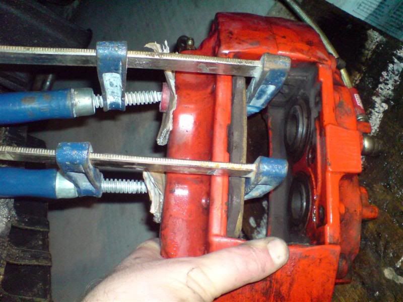

G - Before putting the caliper back on youll need to push the pistons back in. If you cannot push them in with your hands, slide the old pad into position and place one or two C clamps against the pad and caliper (as show below). Tighten the C clamps until the pad is flat against the caliper. Do this to both side so that all 4 pistons have been pushed back in.
BEFORE
AFTER
