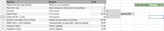

Some of the expenditure so far, the below are yet to be fitted apart from the centre cap vinyls. Hoping to have the car daily ready by November 5th
