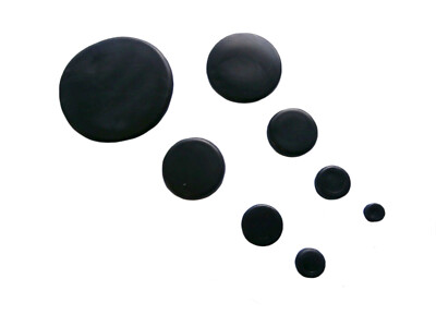

You can buy a bung on ebay to stop this happening but called it right :)
Do you have any details, Happy_2008? What is it called? I want to prevent this from happening again in the future, if possible.
