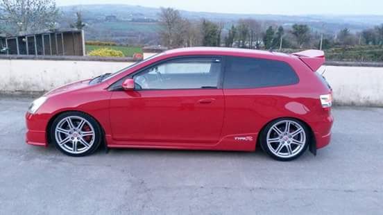

Anyway, some pics of the headache honda.
