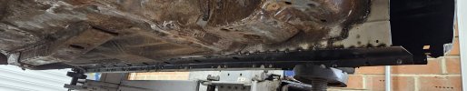

Anyway, here are some photos!
Car was sat in a field for approximately 4 years. Corrosion shows this.
Since the car was delivered, in a bid to get the car mobile for ease of positioning.
I have drained the fuel tank, and replaced with 5 litres of fresh V-power unleaded.
- Replaced 4 spark plugs.
- Squirted 5ml of fresh engine oil in each cylinder and left to sit for a couple days.
- Installed new battery.
- Attempted to start.
Car started immediately to my suprise, idle control valve is stuck so car is idling erratic i will post more on this, however the entire engine will be coming out to deal with all the rust And timing chain etc.
