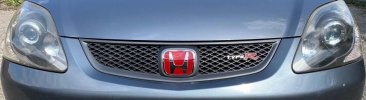

Next job off the list, replacement front H badge. When I bought the car, the original badge had a stone chip in it and had gone a manky brown colour. Got round to getting a replacement badge and set about changing it.
First up, grill removed:
I took the opportunity to clean the bumper underneath where the grill sits while it was off.

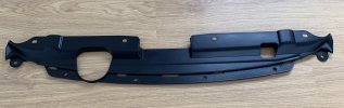

On a separate note, on removing the black plastic slam panel cover, this revealed some surface rust. I rubbed it down, used Hamerite Kurust on it and painted it, followed by a coat of wax.
Right, old badge vs brand new one:
Lovely stone chip/crack on the left of the H!
Also gave the plastic cover the Autoglym treatment:
Most of the plastic clips holding the grill/cover in place were past their best, so I ordered some more.
Grill with new badge refitted, along with the treated/painted/polished slam panel:
And finally, grill fully fitted with brand new clips:
Much better :D
