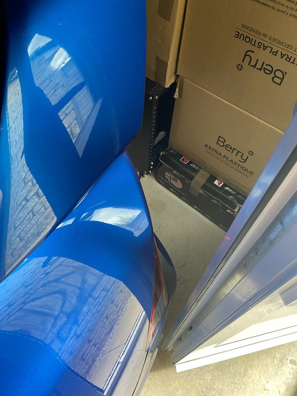

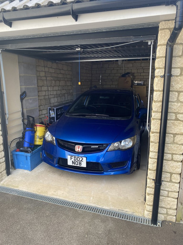

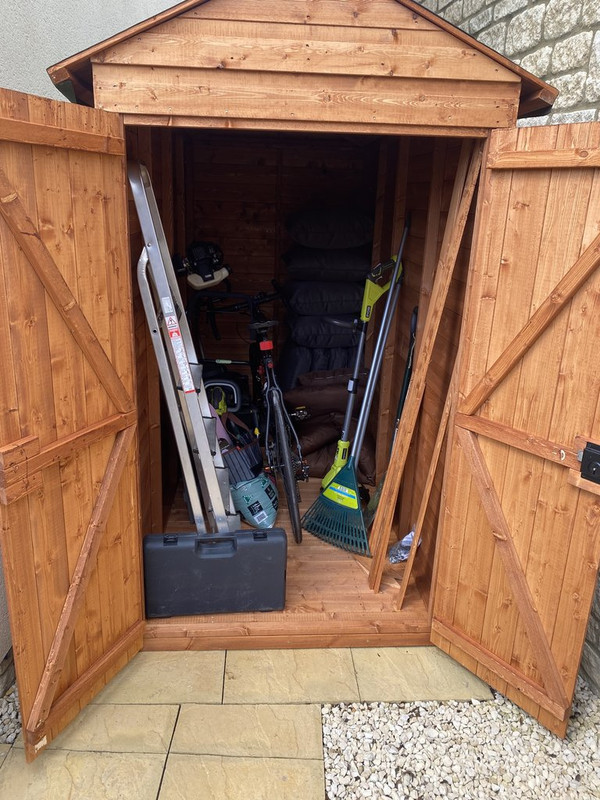

Bought a shed, built it and filled it.
That allowed me to finally put the FD2 into the garage at the new house.
Unfortunately I can't open the side door with the way the car is. Once I get some shelving up and have another sort/clear out I should be able to angle the car differently allowing the door to fully open.

Clearly nobody who designs these houses actually intends anyone to use the garage for parking a car. :rolleyes:
I'd look at either a roller shutter at the front to allow parking closer to it, or changing the access door to open outwards.

I got very lucky with my garage space! Every other house we viewed would have needed an external shed for all the bits and bobs. Only photo I have of it in the garage was my wedding day
Rolling door with remote fob has been ordered as has shelving. It’ll make a big difference for sure.
