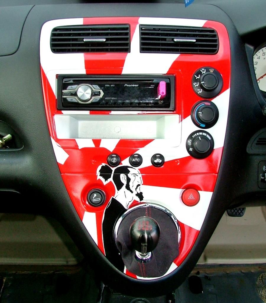

I realised that I never posted a good pic of my current console. Pretty chuffed with it, best one yet I think. It's bugging me that I messed up the top of the sun where it meets the stereo fascia, but not enough to fix it.
looks very clean mate, bet that took a good few hours to get to that stage, especially with one good arm :)
Thanks chaps. Yeah it's slow going with one hand, but I can't complain, it's better than working in this weather! I'm really enjoying myself actually. Made some new plans, a few more dumb ideas, found a few more challenges. Lots more updates for the next few weeks.
Cigarette lighter not level; argh!....
Lol, that's the first time it's been in place in a year, just found it again today. I'm going to go make it perfectly level now, just for you and your ocd. But, I'm going to level it upside down. :smt064

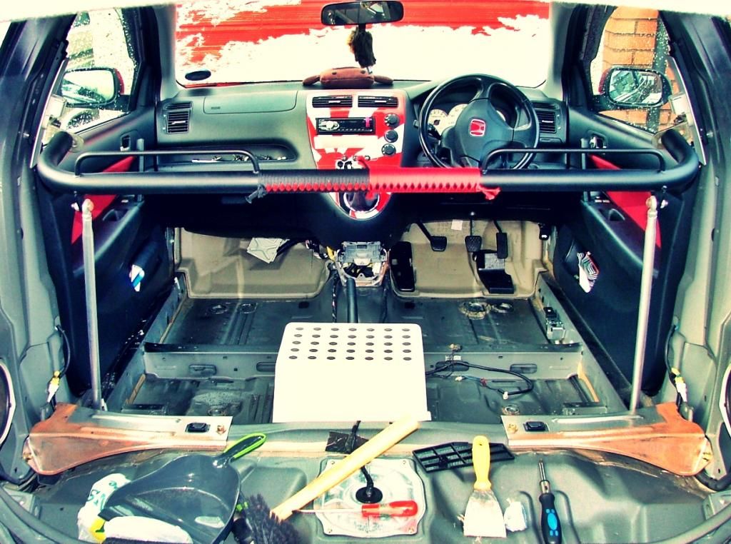

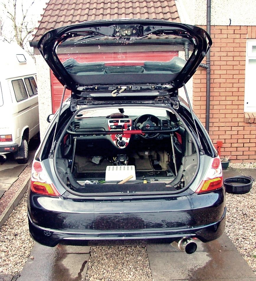

I've been stripping out the sound deadening material bit by bit over the last few days, it's horrible stuff. It comes off fine until you get to a bit where it's stuck over seam sealant, then it's stuck like s**t to a blanket. I was doing the bit behind the drivers seat toady and found this:
I was not expecting that. There are two holes that go all the way through. Of course I'm upset to find that on a 10 year old car, but I'm looking at the positives; I'm mighty glad I found it before it got any worse, it probably couldn't have happened at a better time because the car is in bits anyway, and it doesn't appear to be a difficult repair.
So the car will be off the road for a while longer as I don't have the money to get it fixed right now. Once it's driveable I'll take it to a bodyshop and have it thoroughly investigated, who knows what else is lurking under there.
Unfortunate, but as you say, much better to discover it this way. If you find yourself swimming in money at any stage you could have the chassis seam welded at the same time. And fit a cage. :twisted:

Wow didnt expect you to post that up under the sound deadening!!!!!
Kudos for getting it all out one handed. What method did you use?
Centre console looks great as always!
Yeah, it was a big surprise for me too! I suppose that's what the highlands does to cars.
The sound deadening took ages. I chipped it off with a screwdriver, came off easily enough in the cold weather. Then scraped the sticky stuff off with the screwdriver. Then a bit of white spirits and a wire brush on the drill. Then more white spirit and a scourer sponge. THEN start on the stuff stuck to the seam sealant, that bit was soul destroying.
I weighed it afterwards, even the stuff from the hoover, so I estimate 99% of it.......... 1.1kg. And about 9 hours.
